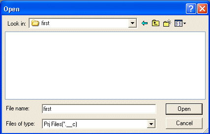

Open the New Project menu:
Give a filename for your new project (I called mine first.__c) :

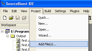

Add the sources for the project using the 'Add files' option :
This should produce a workspace looking something like this :
